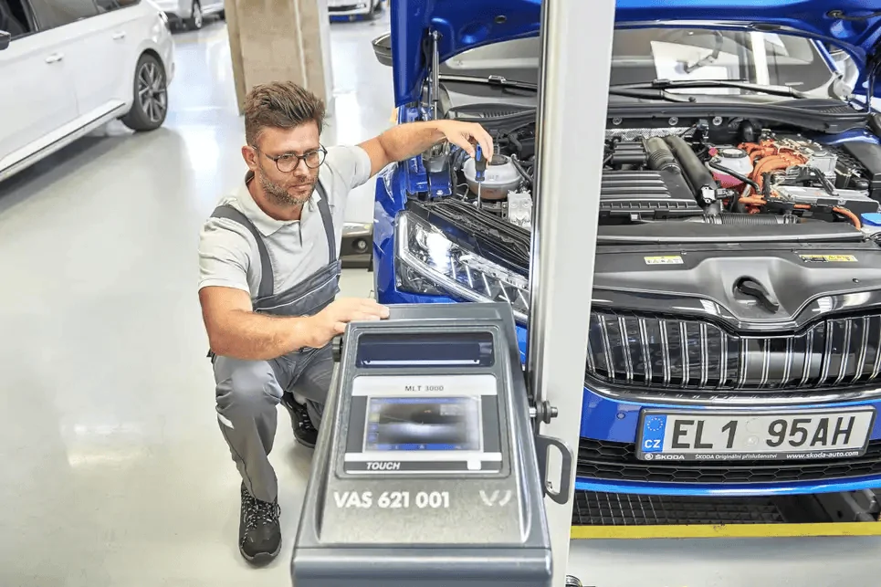

Škoda wants to convince people about the benefits of switching to EVs by going after the dreaded maintenance and service intervals needed to keep ICE cars running. The Czech carmaker claims that counting miles will be unnecessary for EV servicing schedules, due to their mechanical simplicity. The only thing you’ll have to remember is a two-year time period in between shop visits.
It doesn’t matter if you drive 12,000 miles or 120,000. Škoda says your EV won’t care; the only measure needed to track upcoming service is going to be time. The Škoda Enyaq IV, which is like the VW ID.4's cousin, will need to visit the shop every couple of years, according to the carmaker:
For the customer, though, these cars are in fact a relief as far as regular servicing goes.
“The ENYAQ iV is the first ŠKODA whose service frequency is not influenced by mileage. The car ought to be serviced regularly every two years,” says Karel Starý, Head of After Sales at ŠKODA Czech Republic. So the electric SUV’s owners don’t have to keep an eye on their mileage at all.
The carmaker’s claim is not that revolutionary; fewer parts need fewer shop visits. And even though Škoda is touting the benefits of owning the Enyaq IV, the list of maintenance items it mentions applies to many other EVs.

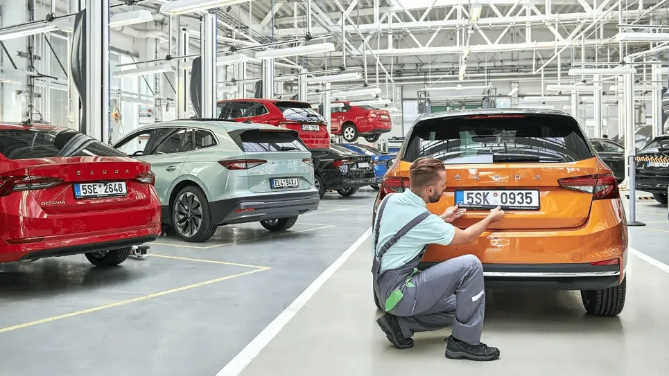

When it’s laid out, the maintenance items are relatively few. Škoda lists the following items as those its techs will look at during infrequent shop visits:
...there’s no need to change the oil, oil and fuel filters or spark plugs. The only standard tasks left are changing the interior dust and pollen filter, brake fluid, and checking the air conditioning, wipers and other consumables. Electric cars also have to have their coolant changed after a few years, but even this is cheaper than similar servicing for conventional cars.
Notice coolant flushes are still in there, along with brake fluid. Škoda says that EV braking systems will see less wear, though, which means replacement of its components will be required less often. Meanwhile, other “wear items” will be gone altogether:
And an electric car saves on service costs in other ways, too. “Thanks to recuperation, electric cars go easier on the braking system, and there is no need to replace worn parts such as timing belts, injectors, the clutch, dual-mass flywheel, particulate filters, EGR valve, turbocharger and other parts,” says Karel Starý.
Of course, Škoda admits that battery degradation will happen, but it’s being a little optimistic about the need for those repairs. The carmaker says that when the battery goes bad, it’s rarely the whole thing that needs replacing and swapping out the battery module that degraded most is fine. The cost of that service will allegedly be about the same as replacing an ICE car’s turbocharger.
The funny thing about all this is that most people already take a “time-not- miles” approach. Outside of car enthusiasts and the most responsible owners, people just ask when their last service was instead of trying to guess their car’s odometer reading at the time. I’m just happy that responsible car ownership is going to get easier. No more oily napkins with Sharpie-scribbled numbers. No more faded stickers in the corner of the windshield. Suck it, mileage!

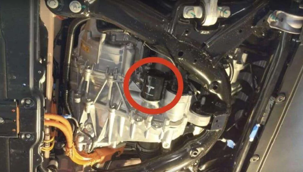

Poke underneath a Tesla with its aero covers off and what you find might surprise you.
Since Teslas are 100 percent electric, you’d think you never have to deal with oil changes and would never find something like an oil filter attached to anything underneath. You’d be wrong because Teslas (at least the Model 3 and Y) do have oil filters. Although the motors aren’t full of oil, the gearbox with its single-speed transmission and differential is. Filtering that oil is a plain ol’ oil filter.
Here’s a closeup thanks to a Redditor.
Cybercab Robotaxi Škoda Says Mileage Won't Affect Maintenance And Service Intervals When Electric Cars Take Over 2021.6.21-Oil-Filter-feat-C-1021x580
Sandwiched on one end of the motor, the gearbox with single-speed transmission takes the raw power from the motor (or motors) and, through gear reduction and torque multiplication, transmits that power to the wheels.
Watch this video clip starting at 6:00 or a better idea of how it all works
To reduce friction and keep gears cool, all those gears are bathed in, presumably, quarts of synthetic oil. Although Tesla uses helical cut gears, friction reduction is not 100 percent and, during the life of the Tesla, through wear and tear, shavings of those gears will contaminate the oil. Those oil filters filter out all the metal shavings.
Tesla Model S and X owners used to require (1) gearbox drain and refill towards the beginning of their ownership to filter out those metal shavings. That’s no longer needed thanks to added oil filters on Model 3 and Y.
While some Tesla owners say you should change those filters every two years, a gear box oil and oil filter change is not in any of Teslas recommended Maintenance Service intervals (linked here.) This suggests those are lifetime oil filters, never needing changing.
Then again, Tesla has a part number {M3} 1095038-00-A for these oil filters, purchasable online.
Looking at these Tesla oil filters, they look pretty ordinary and are probably economy spec made by Wix, Honeywell, or Supertech by Walmart. Seeing how most of their usefulness comes during a narrow window of the total ownership of the Tesla, upgrading to a better filter would be unnecessary.
So yes, Teslas have oil filters, they just aren’t taxed as heavily as they would be in a regular car.

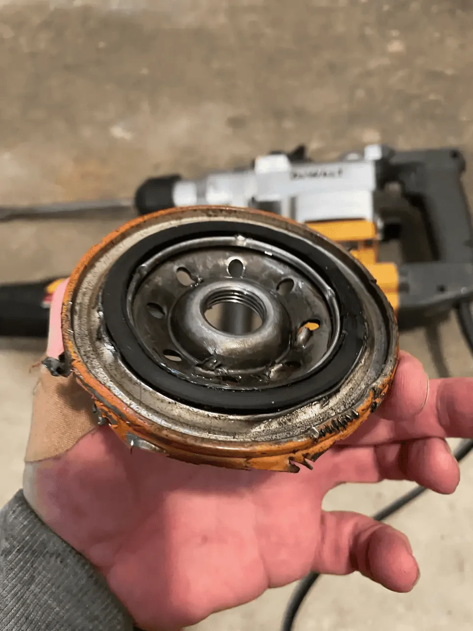

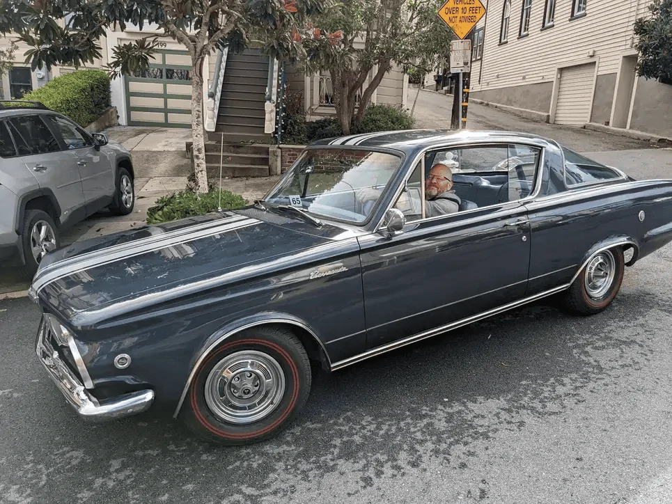

To say Tony Rotundo’s first oil change on his recently-acquired 1965 Plymouth Barracuda Formula S was a disaster would be an understatement. The San Francisco-based wrestling photographer suffered for three days trying every trick in the book, turning a clean orange cylinder into a beat-up thin plate and his excitement for his new car into total exhaustion.
Tony described the photo above. “This is the plate still attached. The phone is right in front of it, which makes it look like there’s a lot of space to work in. There isn’t.”

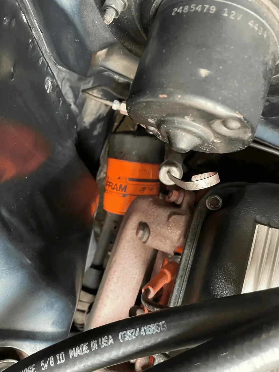

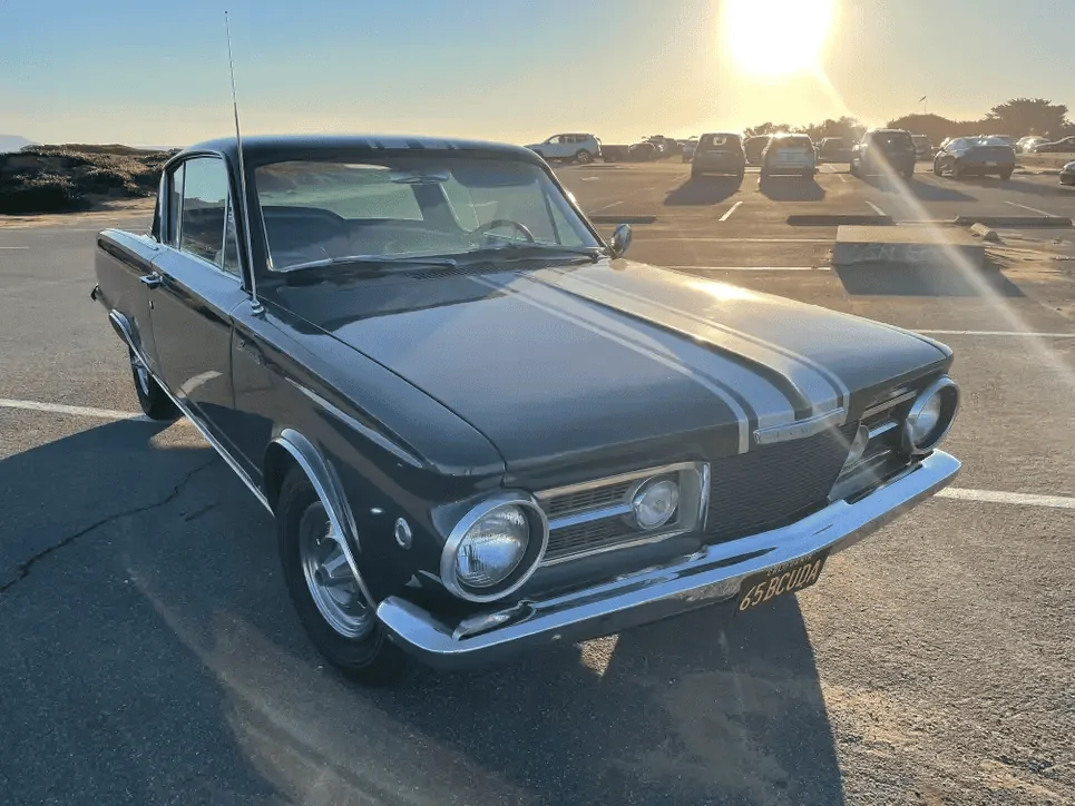

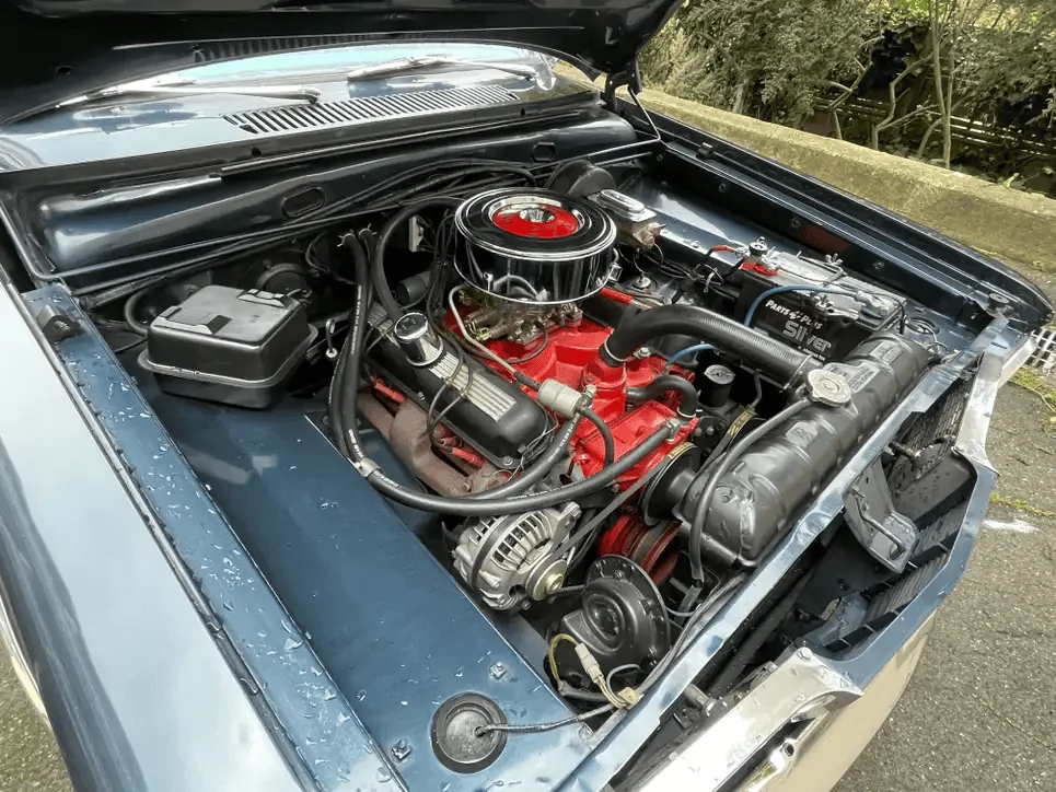

Tony had bought his 273 cubic-inch V8-powered 1965 Plymouth Barracuda Formula S a few months ago from Washington State and had the vehicle shipped to the Bay Area. “The oil change started out innocently enough,” he said as we began our Facebook Messenger conversation, “though I had to run to the auto store to get a steel band wrench that was big enough for the V8 engine.
“However, the filter would not budge, so I went back to the auto supply store and got a rubber band filter wrench, and that actually crushed the filter a bit, the first time that’s ever happened to me. At that point I was a bit nervous and stopped for the day.”

Rotundo began doing a bit of research, watching YouTube videos on oil filter removal techniques; a common trick that he heard — and one that I’ve unfortunately had to employ on numerous occasions — is shoving a screwdriver through the filter casing and using the handle to gain a moment-arm to turn the canister. At the time, Rotundo thought this was a drastic measure. “But little did I know that was nothing,” he foreshadowed.
Rotundo texted the previous owner to ask if there was a trick to the whole oil filter removal process. “It turns out he had never changed the oil in the three years that he owned the car. He said he didn’t drive it a lot. I guess he avoided the catastrophe that was about to unfold for me. Lucky him.”

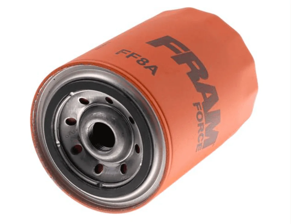

This is how the oil filter looked pre-shitshowImage: Fram
Things went south quickly. “At every point of the process, the next step seemed more and more outrageous. I thought, ‘Well, if I commit to the screw driver through the filter that will surely get it off.’ It didn’t,” Tony recounted. “In fact, the screw driver just crushed the can more. It was a waste of time. I stopped again for the day and spent the evening thinking about the next move.”

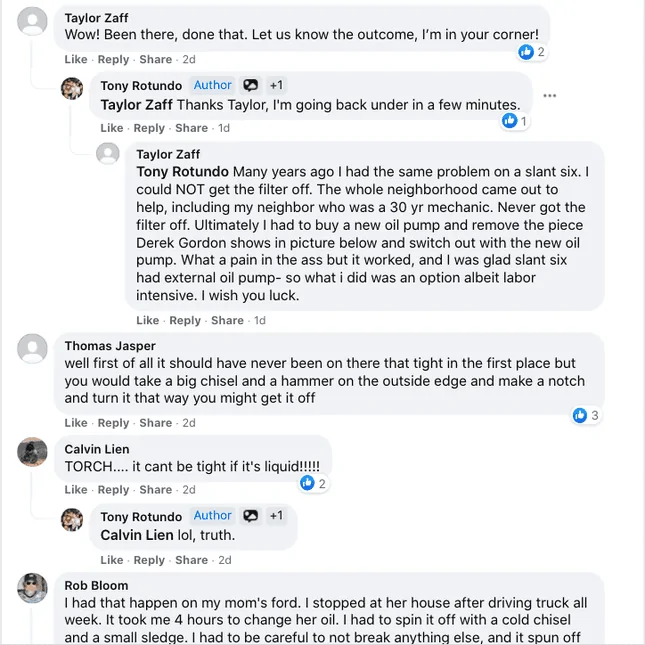

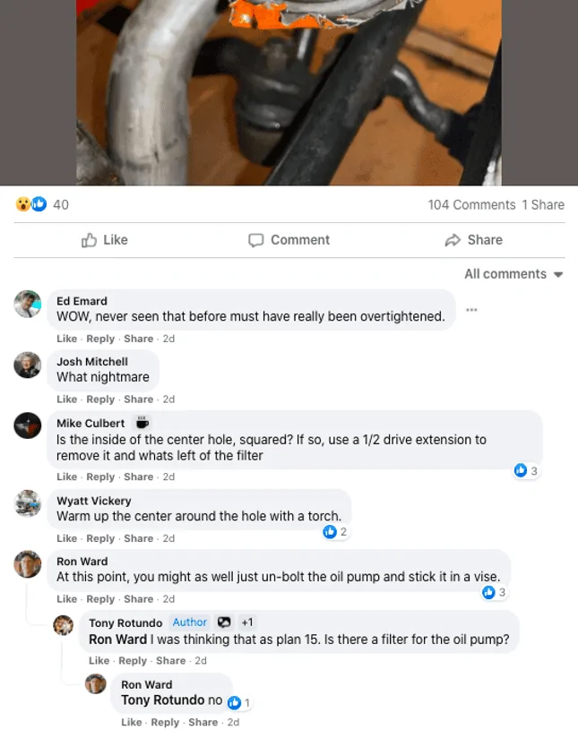

Rotundo wrote about his saga on the Facebook group “The Early Valiant and Barracuda Club Group” and received over 100 replies from people who understood his pain. Far too many folks in this world have struggled with over-tightened-oil-filter-itus. In an attempt to reduce worldwide suffering, I wrote an article in 2018 titled Stop Screwing Your Oil Filter On So Damn Tight. (In that article I mention that prominent oil filter manufacturer Wix recommends turning the filter just 3/4 of a turn after its seal has touched the oil filter housing; I tend to do just 1/2 turn).
Cybercab Robotaxi Škoda Says Mileage Won't Affect Maintenance And Service Intervals When Electric Cars Take Over 1642467994148
Screenshot: Facebook (Other)
Cybercab Robotaxi Škoda Says Mileage Won't Affect Maintenance And Service Intervals When Electric Cars Take Over 1642468001822
People on the Facebook page commiserated and suggested all sorts of solutions, including removing the oil pump. On an older Plymouth, that’s not the end of the world, but it still constitutes an absolute shitshow when compared to the five seconds this task should have taken.
Rotundo didn’t undo the oil pump, though. He had sprayed penetrating oil where the filter met the threads, he’d dumped Goo Gone onto the base of the filter (presumably to try to soften the gasket which might have been sticking), and he’d applied heat. The next step was to break out an impact hammer and then remove parts of his car to get more room to whack.
“People [on the Facebook group] talked about banging on it with a hammer, so I even brought down a muscle massage device to really bang on it repeatedly. (It goes without saying, there’s very little room to work with. I was looking for parts I could take off and get out of the way, like the transmission dip stick.)” told me.

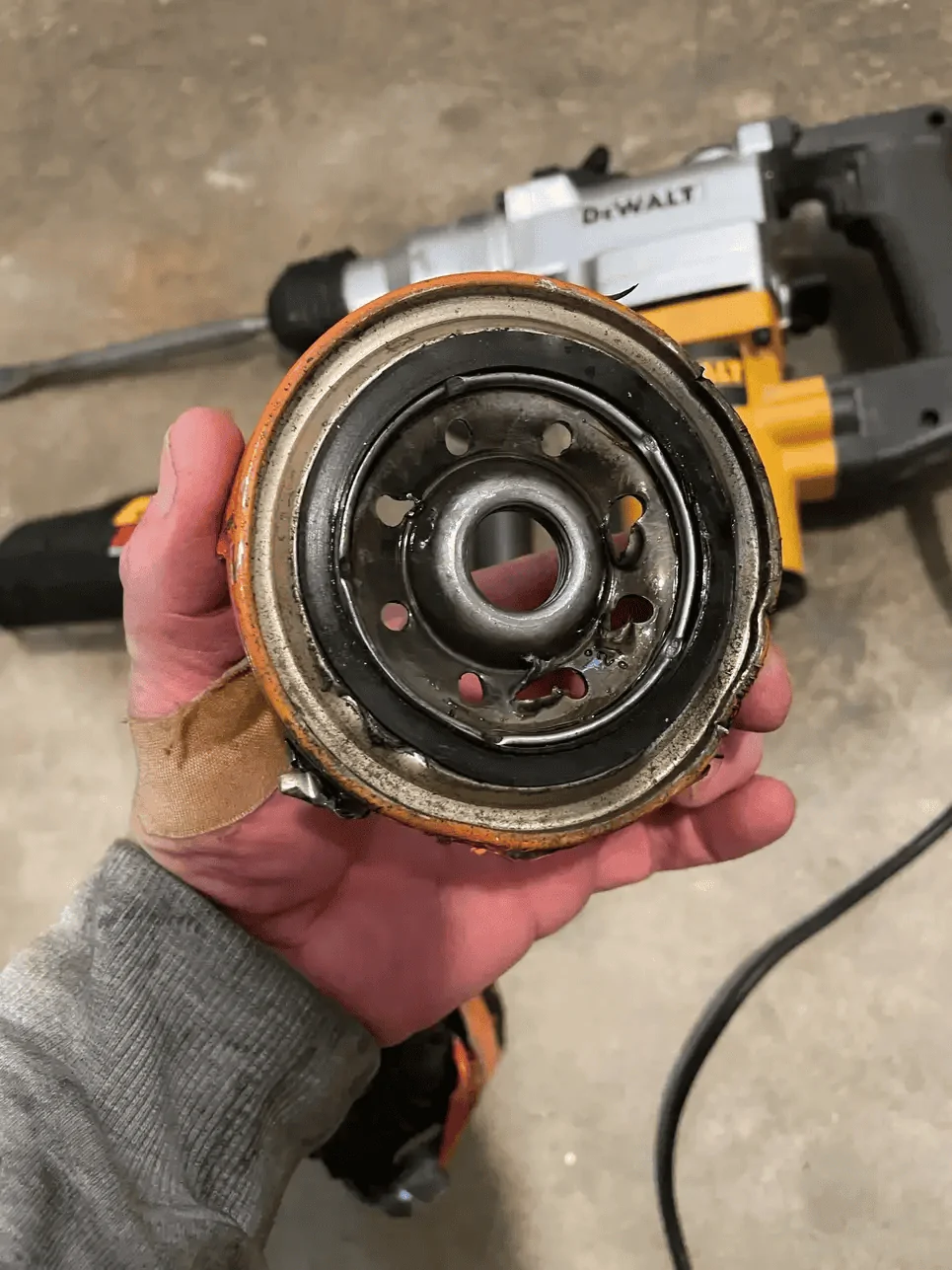

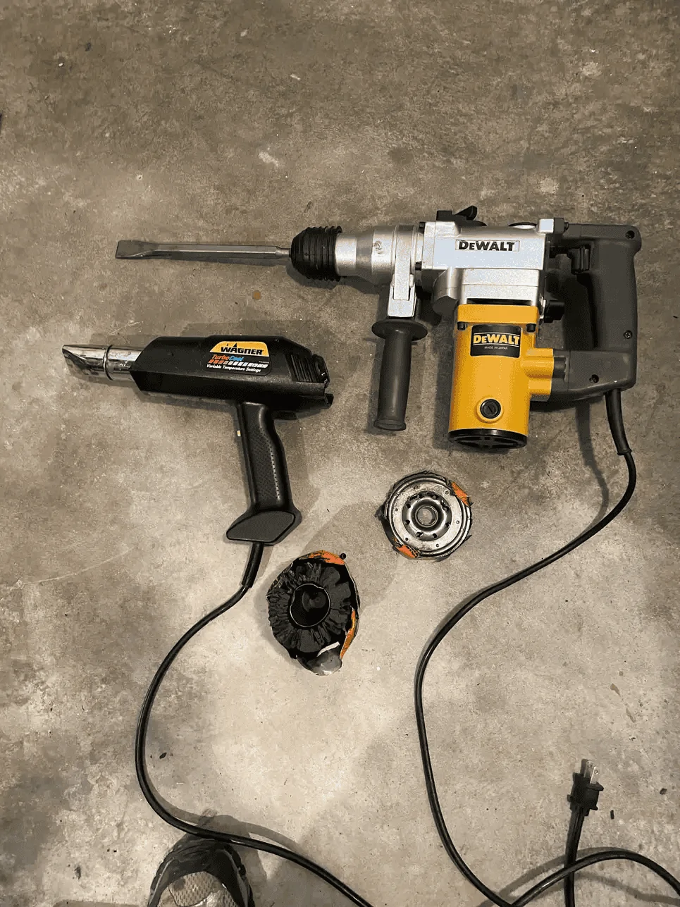

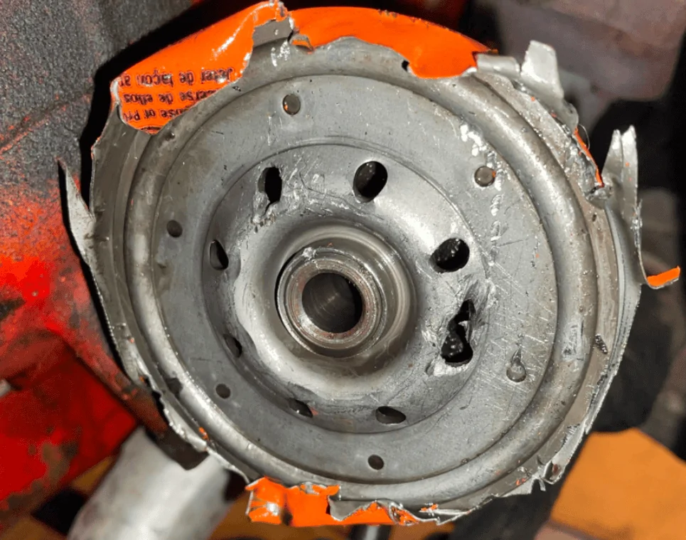

“On the third day, I committed to cutting the can off entirely and tackling just the metal plate. I put some heat on it, but not enough, and was able to get an impact hammer with a chisel bit into one of the filter holes.” Despite this — and despite shoving hot razor blades between the gasket and engine — the filter wouldn’t budge.
“That night, folks in the forum recommended a number of things. One was to take off the oil filter adapter, but when I checked that out, I didn’t have the inch+ socket. The most common thing folks were recommended was heat, so I decided heat and the impact gun was the way to focus. And that eventually got it.”
“SUCCESS! All Fram filters bow to your new overlord!... I was victorious against the mighty Fram Filter. Whew!!” Rotundo wrote on the Facebook page.
“I used a heat gun, not a propane torch, because I really didn’t want to light my car on fire,” he told me. “So I just heated and heated and heated from above and under, and then hit it with the impact [hammer]. The first time I saw it budge, which was a millimeter, I screamed with joy and knew I had it. But, I still had to heat more, and hammer more, moving it a mill at a time, until finally it spun free.” What a saga!
Tony came out mostly unscathed. “The bandaid in the pic was a small cut from this. I always remember to put on gloves after the fact,” he told me. “I lived on a farm outside of Buffalo, NY, and was a wrestler (I’m a wrestling photographer now), so I tend to throw my body at problems pretty hard. By day three I was fully geared up, though I did have a drop of warm oil land in my eye on day three.” Could have been worse, I guess. But should have been so, so much better.
Cybercab Robotaxi Škoda Says Mileage Won't Affect Maintenance And Service Intervals When Electric Cars Take Over 1642468019970
Photo: Tony Rotundo
Rotundo suspects that whoever had done the oil change last tightened the filter so much that it actually crushed the base plate. “There’s damage to the plate that I didn’t do, so not sure what monster spun that thing on,” he concluded.
How absurd. Remember folks, over-tightening oil filters ruins lives. Don’t do it.

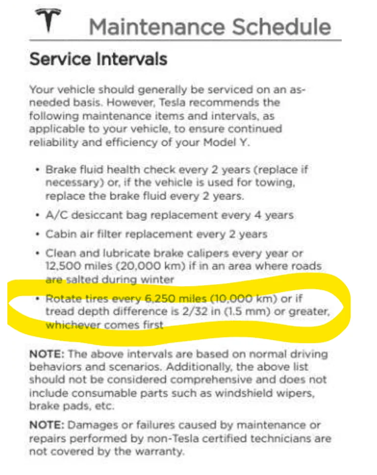

Are you talking based on a personal experience or just your opinion?
Electric cars are much heavier, and tires do not last as long as on ICE cars even though weight is more balanced between front and rear.
"How Long do the Tires Last?
A set of tires will last you around 20,000 to 25,000 miles in the Model Y.
Teslas and other performance oriented EVs tend to wear out their tires more.
This is due to the instantaneous power that the motors can deliver which exerts a lot more force on the tires.
To make a set of tires last longer and make sure they wear out evenly, you also need to rotate your tires every 6,250 miles or if tread depth difference is 2/32 in or greater, whichever comes first.
https://enginepatrol.com/how-long-tesla-model-y-last/
And a screenshot from tesla:
Cybercab Robotaxi Škoda Says Mileage Won't Affect Maintenance And Service Intervals When Electric Cars Take Over 1642702822302
PS. Have never heard that any Skoda has All Wheel Steering.
PSS. Before posting something you are not sure 100%, please google it first, or specify that it is your personal opinion. There are a lot of people that have never driven EV and they buy your opinion as a clear fact.
PSS. Nothing personal
