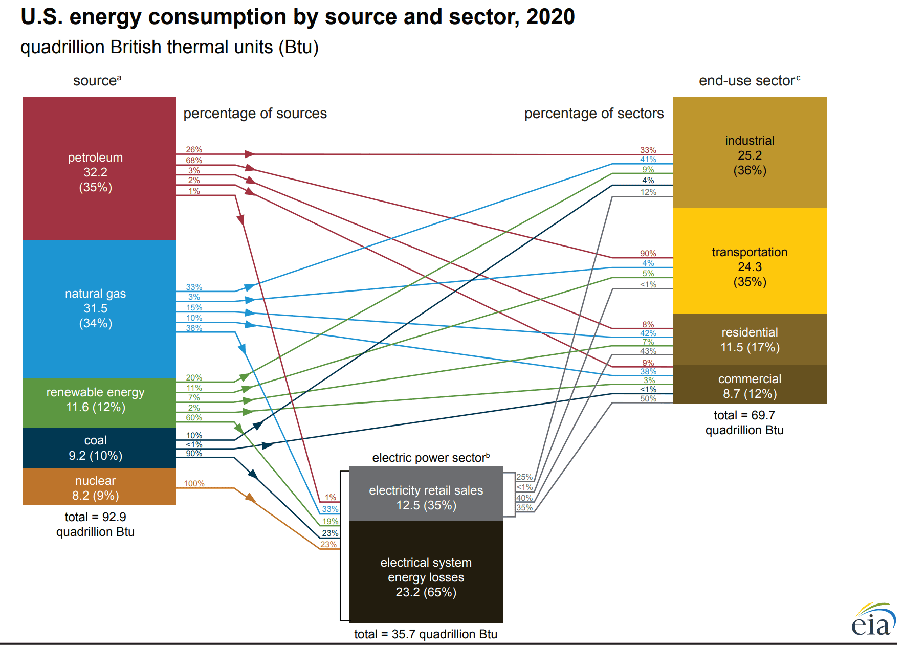

https://www.eia.gov/energyexplained/us-energy-facts/#:~:text=In 2020, total U.S. primary,or about 93 quadrillion Btu.
https://www.eia.gov/energyexplained/us-energy-facts/images/consumption-by-source-and-sector.pdf
Even if you take just transportation and residential we will need more than double the electricity generation we have now. I had no Idea that heating was more than half of home energy usage.
Edit: Probably closer to between 30% and 40% as far as peak capacity due to timing.

The challenges I am referring to is being able to produce enough electricity to avoid rolling blackouts. As we shut down fossil fueled power plants, transition homes fossil fuels for heat, and transition to electric for transportation things can and I expect them to get pretty dicy. Replacing 60% of our generation capacity while increasing peak demand.
Our current generation capacity is 1.12 billion KW. If you leave nuclear on we need to replace 672 million kw while adding another 336 million kw (30% increase). That is nearly building a whole new grid minus the power lines. Many want this done within the next 30 years. Its not undoable but will definitely be a challenge.

This is misleading because it doesn't account for efficiency.
For example, as we switch from oil and natural gas heating to modern heat pumps that run on electricity, the efficiency goes way up. So we can replace 3 units of fossil fuel energy with one unit of electrical energy.
Also, EV's are about 3 times as efficient as ICE cars so the amount of energy required is 1/3.
Another factor not many people understand is there is a lot of electricity involved in the refining process and that is why every oil refinery has it's own electrical power substation. As cars transition off gas, refineries will go off-line freeing up huge amounts of electrical generation for other purposes.
Said another way, you cannot compare energy directly across sources because fossil energy reguires much more input to achieve the desired effect and this inefficiency compounds itself across various stages of energy use. You may only get X number of BTU's delivered by oil, natural gas or coal to heat your home but those BTU's have a lot of electrical energy embodied in them by the time they reach your home. In comparison, the losses to create and deliver electricity are relatively small.
So the challenge facing us is made to look insurmountable by vested interests trying to convince us that it's a more difficult job than it actually is. The truth of the matter is, it's actually quite simple. We just need to displace the vested interests and do it.
No.
Peak is in watts.
Total is in watt-hours.
These are not comparable.
EVs do not meaningfully increase the Peak, while it massively increases the Total.
