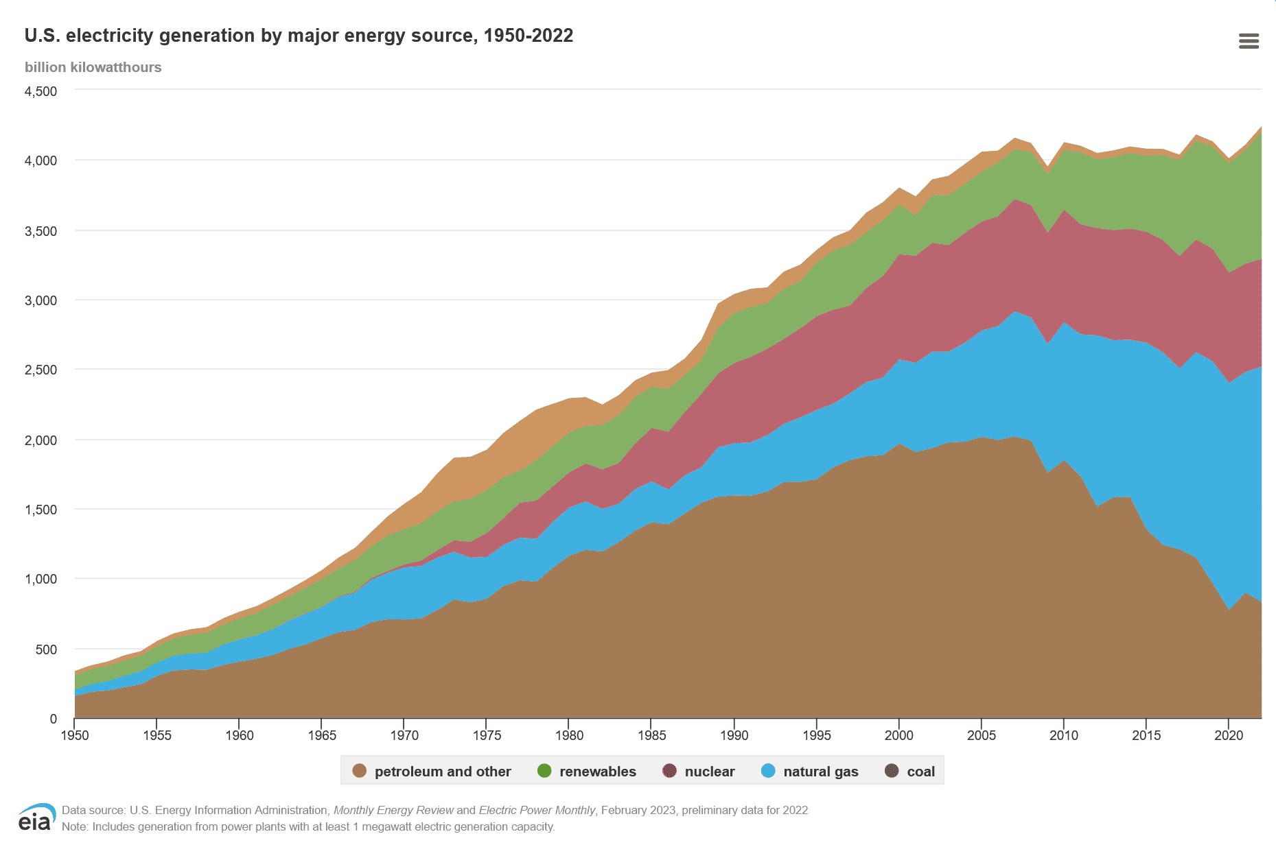

The growth of the electricity grid over the past 70 or more years has been increasing substantially already, although a plateau since 2005 has been result of accelerated reduction of petroleum usage and heavier dependence on other forms of energy. But the trend is still going up and renewables are just beginning to increase to their more used potential.
Most US homes have been using roughly an average of 877kwh electricity per month (although the amount can vary a lot), and if one charges an EV at home four times a month that 's about 200kwh to 250kwh added to that.
https://www.electricrate.com/data-center/average-energy-bills/
So we're looking at roughly a 25% increase in electricity consumption for the average household - but only if they are one of the small percentage of households with new EV owners each year.
What people also are not considering, is that most of this extra home EV charging demand will be placed on the grid at night during non-peak hours when the grid is closer to idle, so the peak demand of any area or substation will hardly ever be maxed out even at current grid capacities from home EV charging.
Of course supercharger demand is different and occurs likely more in the daytime, but Tesla is also taking steps to develop battery storage to buffer and augment sites with heavy peak demands, or at peaker power plants. But a large portion of EV charging demand will be from home charging at night during off peak times.
As @BayouCityBob notes above, these are really just a click-bait nothing burger stories put out by those invested in ICE, legacy auto, or petroleum interests most likely. I've always ignored them and will continue to ignore them.
